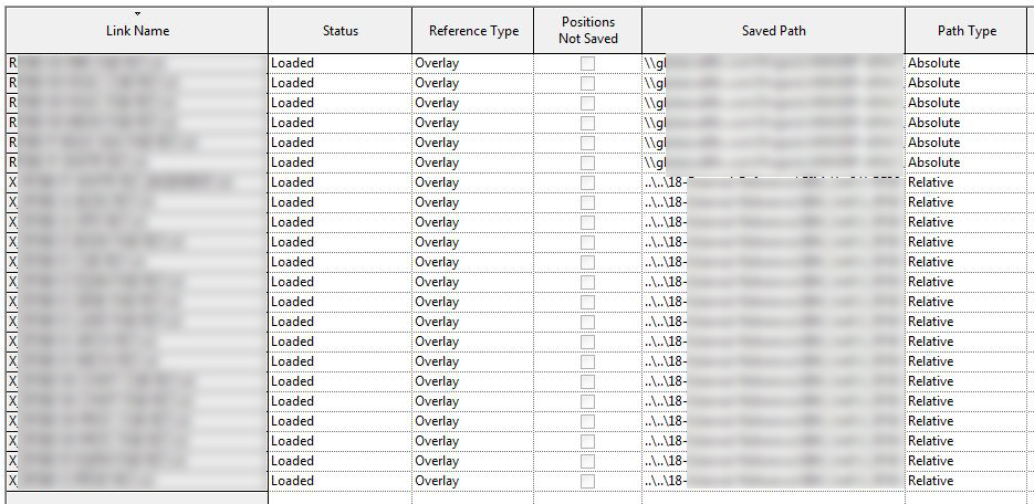

Plumbing = X_Plumbing
I have a mixed file loaded in my project, the ones with the “X” and the ones without the “X”
I need to reload from those files without the “X”
I cannot remove and relink the file as i already have filters and hide elements set…

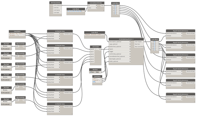

Something like this?
Your graph should work.

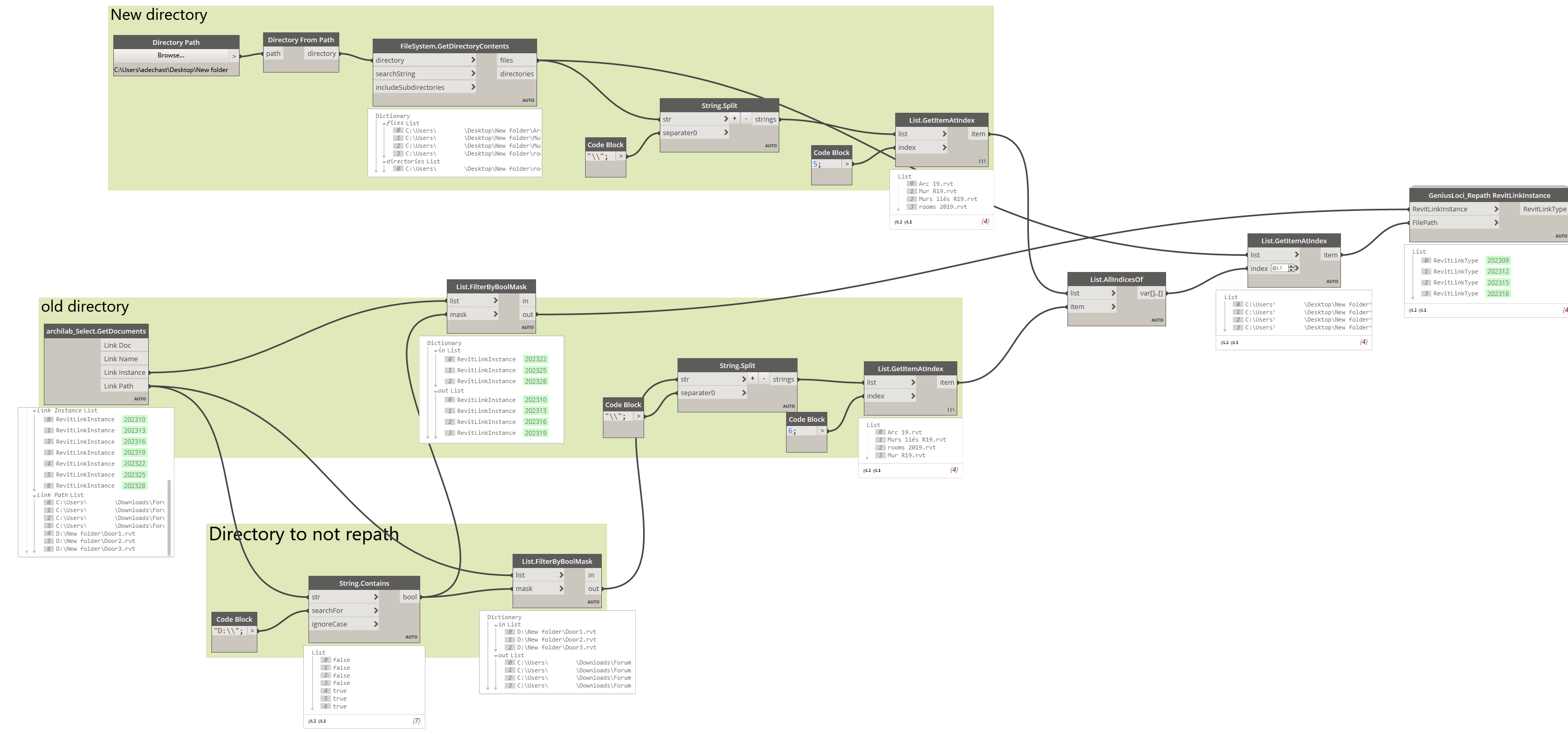

I will have done something more automatic
For example :
Repath%20LinkInstances
Thanks so much! will try this one out.
