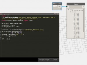

Hi Danny,
It seems I mislead you. Dynamo uses IronPython and not Python and thus it is not compatible with openpyxl. However IronPython can handle excel files natively:
http://www.ironpython.info/index.php?title=Interacting_with_Excel
Hope that puts you on the right track.

I have same problem, but that solution isn’t working for me. I have an error: “ImportError: No module called Office”. Can someone help?
Rade, keep in mind that you have to sset your python paths to where your libraries reside!
I’m beginner, don’t know how,I’ve been searching for hours, and found some xlrd libs but don’t know where to put them to work. Dynamo has some interop.dll, but I don’t know how to call that from Iron Python running from Dynamo.

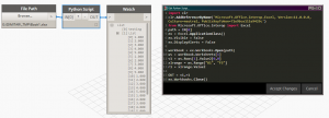

Good call Dimitar, but remember to realease the COM object when you are done with reading it or you will have some trouble later.
Remember that you are instantiating a new Excel Application when running this code so it will have to be closed/released. Try CTR+ALT+DEL and see how many Excel apps you have open. Reading isn’t too difficult but writing gets a little touchy about this.
Good catch, Konrad. I didn’t notice that when testing because I only ran it two - three times. Rookie mistake
If anybody’s trying to use the above code, be sure to add “ex.Workbooks.Close()” after you’re done extracting the info from excel, otherwise a few hidden instances of excel will be eating up your ram.
Hahahah, yes, and no. ex.Workbooks.Close() will only close the visible/hidden instance of Excel app. There is still a COM object running in a background for every worksheet, workbook and excel app. The proper way to make sure that you really closed and released all COM objects is to do the following:
xlApp.ActiveWorkbook.Close(False)
Marshal.ReleaseComObject(xlWorksheet)
Marshal.ReleaseComObject(xlWorkbook)
Marshal.ReleaseComObject(xlApp)
You see how I am dumping not only the Excel Application but also a COM object for a Worksheet and a Workbook. This makes sure that there isn’t anything left open in the Task Manager.
