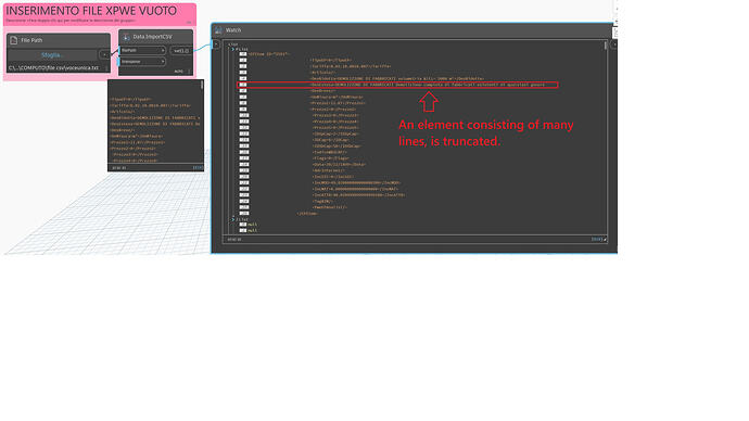

Reading a CSV text file
An element consisting of many lines
is truncated.
Is there a way to read the entire file?
See images.

Thanks for the reply.
The
File.ReadText
command works well, but the problem is the file reading time... even an hour...
The CSV command skips long elements, but reads the file in a minute.
I don't know how to do this.
Regards
