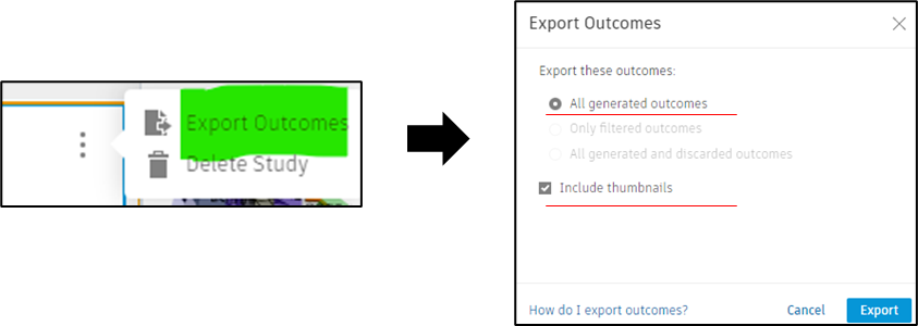

Is there any way to export or download the various generated results that can be viewed in Explore Outcomes? image (When the “Include file dependencies” button is unchecked and there’s no dependencies folder)
I understand that the “Export Outcomes” function can’t be used to transfer and link to Explore Outcomes on a different computer.

Thank you for your answer. After checking your response, I understood that the “Dependencies” folder, unlike the “Explore Outcomes” image data, is specific to a user’s computer and is not shared.
In conclusion, I realized that the only way to share results from “Generative Design - Studies” is by using “Export Outcomes.”
