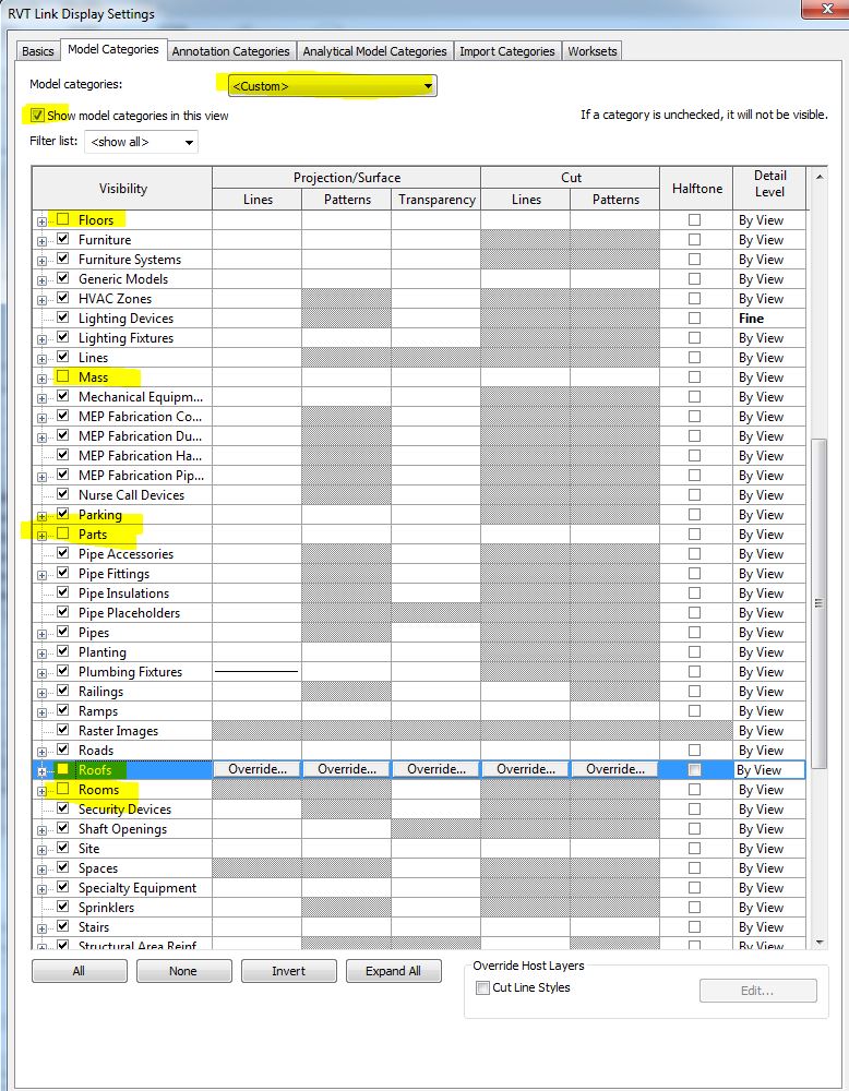

We turn off GRID, LEVEL, SOME TAG on V/G of every linked file in every VIEW TEMPLATE (about 7 View Templates per Project). But when it change and reload, we have to turn off it again and again. It’ s too much.

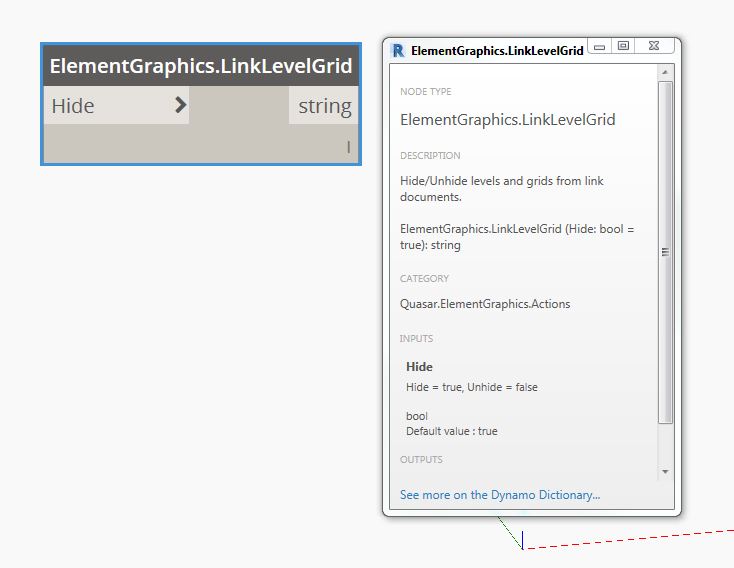

How can I solve this problem by DYNAMO? Run Dynamo and then it changes V/G - REVIT LINKS from By Host View to Custom, then Turn off GRID, LEVEL, TAG.
Note: Arch, Struc, MEP teams are not from one company. We are three different companies and two different countries. Once they update Struc/ MEP file, they send the file to us and we reload linked file. We have to turn off GRID, LEVEL, TAG on V/G of every linked file in every VIEW TEMPLATE again.

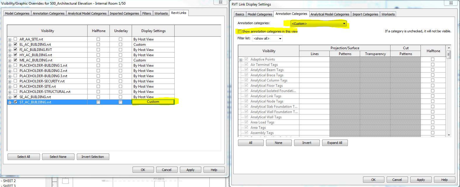

Thank you. Just like this:
About Level and Grid, I rename Type name of Level and Grid in Arch file. Then create a filter. But with RVT Link Display Settings, I have to edit every view template. And if Struc/ MEP teams send us new Struc, MEP version; RVT Link Display Settings return to BY HOST VIEW and I have to edit again.
