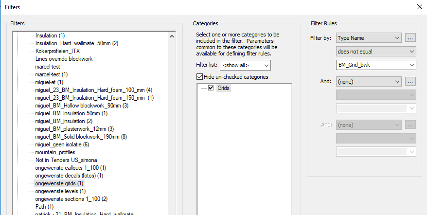

@SPARTAN
Rename your Grid and or Level type, and create a filter so only the type of the model you are working in is shown.
Marcel
That might be a good idea, if I change this in our Template. Will this work for .RVT files mate from .IFC? Do you have any expirients whit this?
@SPARTAN
It will only work for revit Grids.
The problem is that 90% of our links are ifc’s
