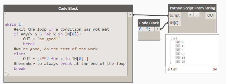

You already pointed out one option - using the break keyword to exit the loop and proceed with the rest of the script:
This is a less than ideal approach because it only escapes the current loop and you might have cases with a nested loop. Plus you always run the risk of forgetting to break from the encapsulating loop.
A much better approach is to restructure your script into functions, because you can return from a function at any point:
