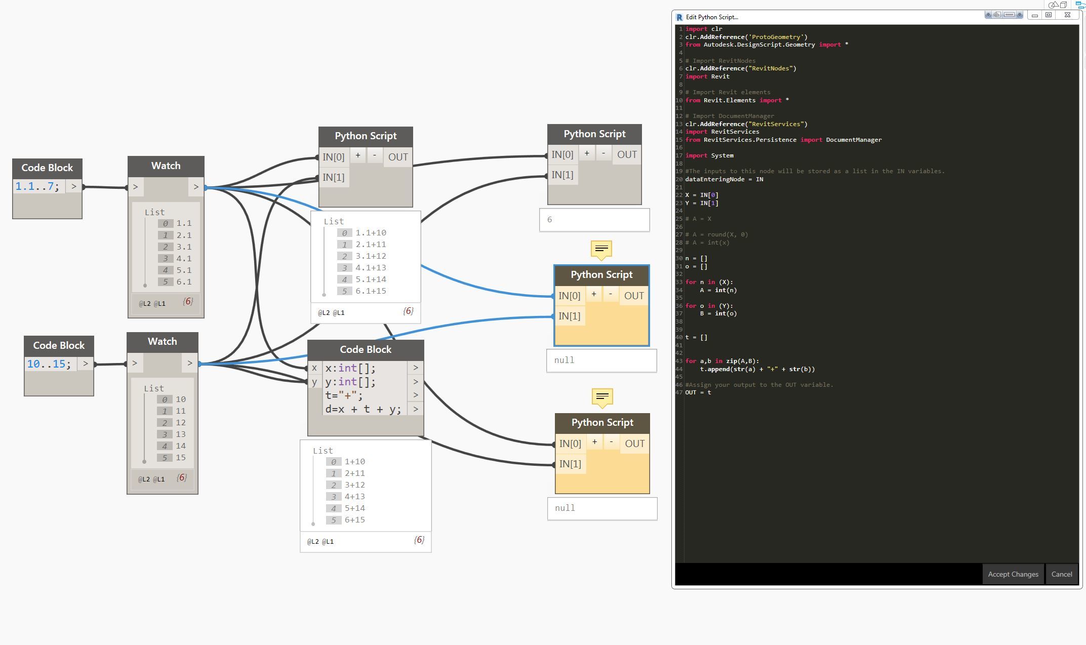

I am trying to get (with python) a list with an integer result (1+10,2+11 etc) just like with the code block
i can get a result with just the last one in a list but not the hole list
what is wrong?
Hello Nico,
In your first 2 loops you’re trying to create an int (A or B) every time you loop over the input. It’s not creating a new list for you. Here’s how you could do it;
thanks
@T_Pover is on the right path but i would modify where the int is added to get away from having two additional temporary lists to manage and do it as the below image.
Exactly!
