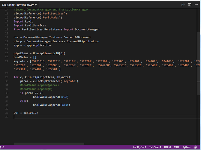

Hej All,
I’m trying to collect some element that have a specific Keynote (list of Keynotes)
but my python script return only False value. I know it should retuen some of dem True.
can anyone help my out?

I think you should only iterate through the list of pipes.
for e in pipeElems:
param = e.LokupParameter('Keynote')
if param in keynote:
boolValue.append(True)
else:
boolValue.append(False)
OUT = boolValue
The way you’re doing it the code tests each pipe with only one value from the list keynote : first pipeelement with 522101, second pipeelement with 52201 and so on.
Hej Mostafa,
It’s still only returns False,
Oh yeah that’s because keynote is a built in parameter.
try this :
clr.AddReference('RevitAPI')
elems = UnwrapElement(IN[0])
keynote = IN[1]
boolValue = []
for e in elems:
etype = doc.GetElement(e.GetTypeId())
param = etype.get_Parameter(BuiltInParameter.KEYNOTE_PARAM).AsString()
else:
OUT = boolValue
Here the keynote list is an input instead of a list typed inside the python script
That’s working. Thanks a lot.
Now i get that idea how to grab the Keynote parameter.
