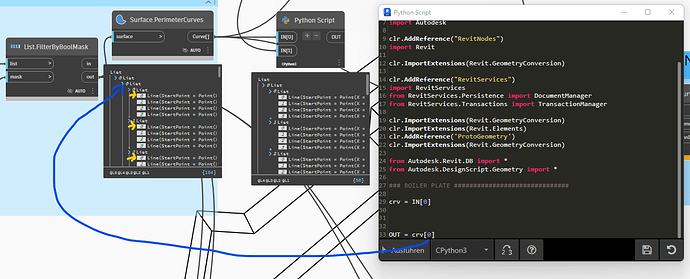

I have a list of lists as input of a python node, and am struggling to get the item at index referring to the lowest level of the list.
crv = IN[0]
OUT = crv[0]
if the above returns the highest list level (blue in picure) of the list, what notation is needed to call the ones in yellow instead?

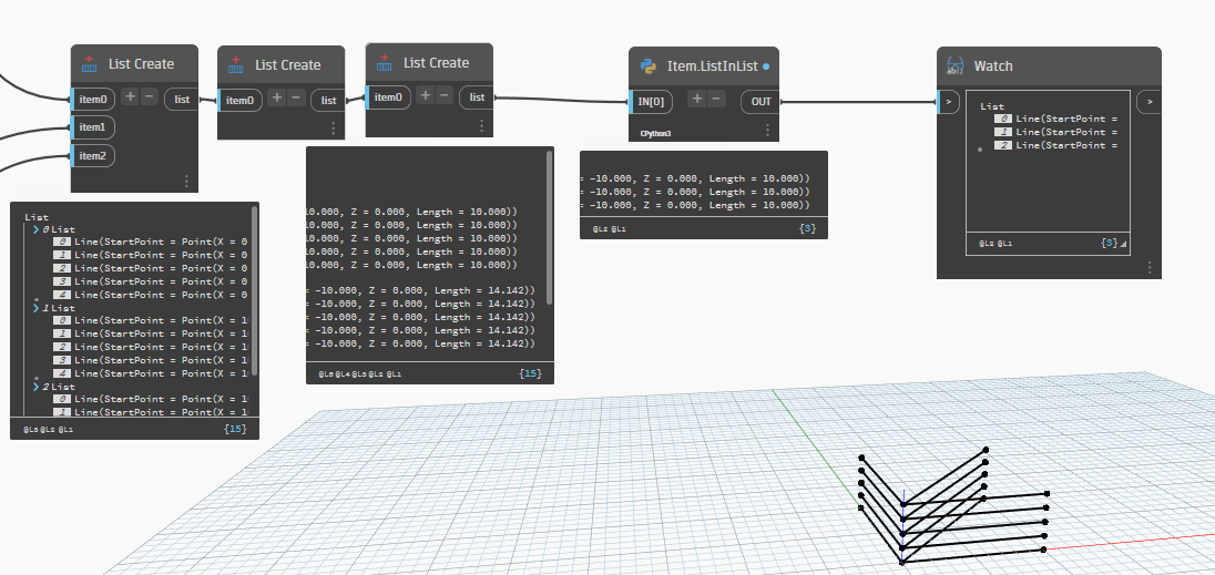

Can you try a tripple for loop … i would also recoment flatten the list… so that you can use just one for-loop
items = IN[0]
OUT = []
for i in items:
    for x in i:
        for y in x:
            OUT.append(i[0][0][0])
