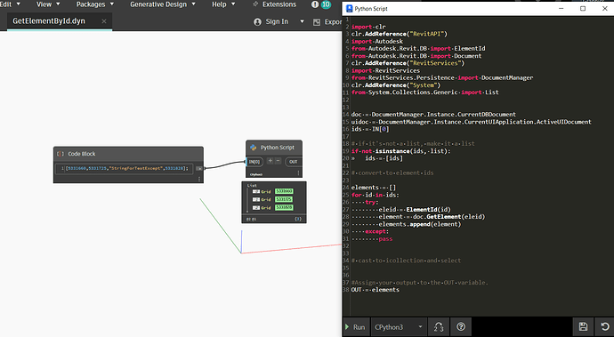

Your program has complications that I don’t think are necessary, According to your purpose, I created a program that can do that with simple logic,
You just need to check if the input is a list, if true: contunute with this one, if false: throw it in a list
Used Try Except Syntax to remove exceptions such as float or string and get results
You can try this.
GetElementById.dyn (8.7 KB)
clr.AddReference("RevitAPI")
import Autodesk
from Autodesk.Revit.DB import ElementId
from Autodesk.Revit.DB import Document
import RevitServices
clr.AddReference("System")
uidoc = DocumentManager.Instance.CurrentUIApplication.ActiveUIDocument
ids = IN[0]
# if it's not a list, make it a list
if not isinstance(ids, list):
ids = [ids]
# convert to element ids
elements = []
for id in ids:
try:
eleid = ElementId(id)
element = doc.GetElement(eleid)
elements.append(element)
except:
pass
OUT = elements

Thank you so much, you are a rock, it works perfectly.
Really appreciate this, now I can compare my code against yours and check the API at the same time.
