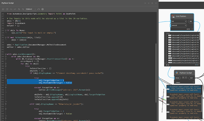

I’m currently facing an issue with my Python script that requires the integration of two nodes that are either missing from the standard node library or not functioning correctly.
  1. SubassemblyTargetInfo.SetTargetsOption: This node is available in the Civil3DToolkit, but unfortunately, it isn’t working as expected. I found an issue related to this on GitHub (Civil3dToolkit Issue #79).
  2. SubassemblyTargetInfo.UseSameSideTarget: This node is theoretically present in the Civil 3D API (version 2024.4) as indicated in the Autodesk documentation (link). However, Python seems completely unresponsive to it.
Moreover, I’m unable to use the setter for SetTargetsOption as I receive the following error: “TypeError: Property is read-only.” Am I missing a crucial step here? Do I need to unlock or somehow modify the SubassemblyTargetInfo object to make it writable?
For context, I can successfully retrieve properties such as LogicalName and DisplayName from SubassemblyTargetInfo at IN[0] without any issues.
I’ve attached a screenshot of a portion of my code below. I would greatly appreciate any guidance or suggestions on how to resolve these challenges.
Thank you in advance for your help!

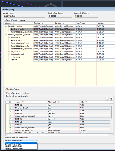

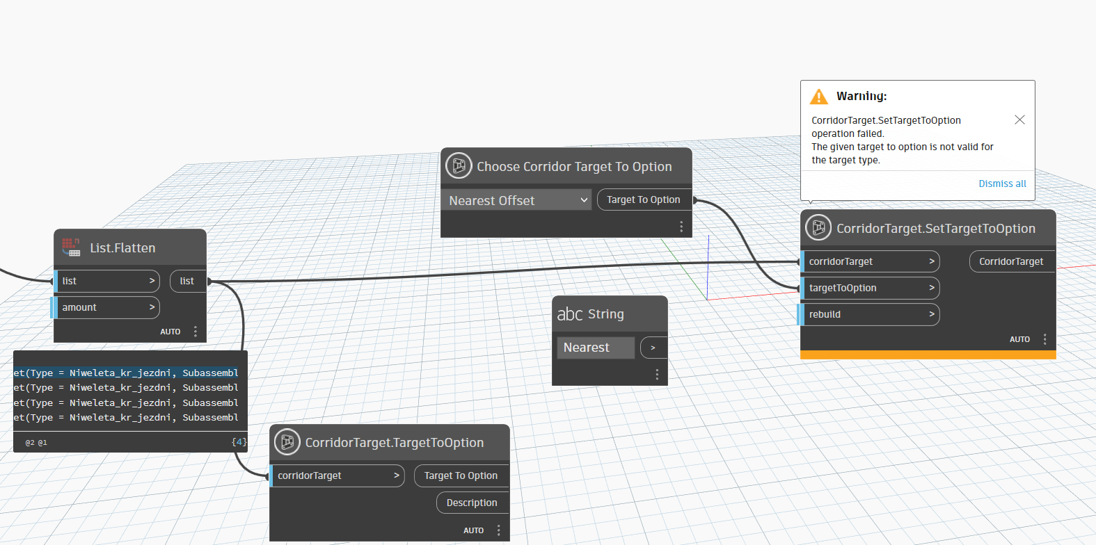

Is there a reason that Elevation type Targets does not accept “Nearest”?
If I set it up manually, I can actually achieve what I want. But I can’t do it through the newest Dynamo for some reason?
Hmm…that seems odd. Let me dig into it and see what’s going on. The output from List.Flatten only contains offset or elevation targets, correct?
Yup - nearest and farthest does not work for elevations for some reason
Yep, that’s a bug. Thanks for flagging this, and sorry for the hassle. You can expect a fix in the next Civil 3D update.

Hi @mchn, just wanted to let you know that the issue with the CorridorTarget.SetTargetToOption has been addressed in Civil 3D 2025.2.
It worked indeed! Thank you!
