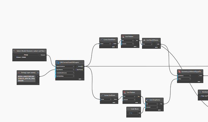

Whatever your input is for ‘curves’ isn’t yet producing any curves, likely as you have not provided one of the necessary inputs to it yet.
Can you share an image of your graph?
i don’t know why i cant share images or videos!!
download it from this link please
