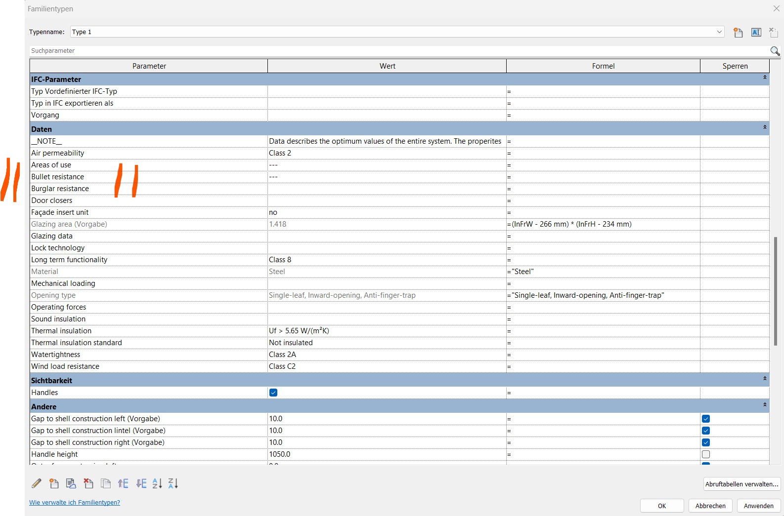

This function is intended to write new parameter values. It works for some parameters, but not for others, even though the type parameters are in the same group (data) and are defined the same way (as text). A mystery? The parameter texts are definitely typed correctly. Does anyone have any idea what might be wrong? Where am I going wrong, what else can I try?
The error says, I think, ‘Parameter does not exist.’ Can you share a sample file to test?
it exist, definitly.

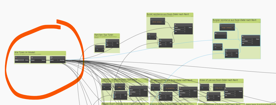

For type parameters, you can’t set them directly on the instance — you have to get the element’s type (FamilySymbol or ElementType) first, then set the parameter on that.
I did that.

There is a node in the Rhythm package called “Elements.SetParameterByNameTypeOrInstance” this node should be all that you need. It feeds in a list of elements, the paraname(string) and the list of values. This is all I ever use to update parameters in a project.
You can actually see in your screenshot that, even though you did get the element types, you’re still passing the element instance on to set the parameter. If you connect the Element.ElementType node to the SetParameterByName nodes you should get what you want.
Oh dear, I couldn’t see the forest for the trees. That must have happened while copying. Thank you very much.
