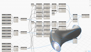

Profile set 1 was created by the ‘NurbsCurve.ByPoints’ node. When I loft these profiles along the 4 NURBSguides everything is fine and works as expected. See image 1.

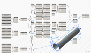

Profile set 2 was created by the ‘NurbsCurve.ByControlPoints’ node. When I loft these profiles the 4 NURBSguides get ignored and the result is a straight loft. No yellow warning is presented. See image 2.
In my opinion this is a bug. Is this the right place to report this issue? Can something be done about this or is this normal behavior?
