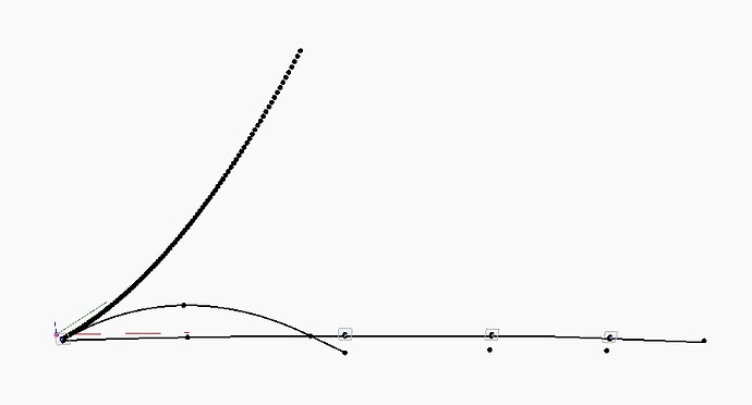

I yould like to achieve to place a bunch of points.
The X coordinates are given, but the Y coordinate is extracted from a polynomial function.
However, my formula does not seems to properly working.
Here is my function (2nd degree polynomial [ax²+bx+c])
(4f/p²x)²+4f/px+0
dyf1
As you can see, points should approximatively be placed on the “arc” curve, but, this is obviously not the case !
Did anybody ever successful with mathematical formulas in Dynamo ?
@BigB Looks like you have written a function for image
And what you are trying to achieve is image
Try this:
fa=4*f/Math.Pow(p,2);
fb=4*f/p;
func = Math.Pow(fa*x,2)+(fb*x);
Thank you @AmolShah, I missed a syntax expression !
But, now, the result is almost a straigt line.
I would like to replicate the Excel function, as per the engeneer’s file.
hi, your error is the “ax^2” term. it should be be “-ax^2”
Thank you @terjefj , you solved the case ! :wink:
