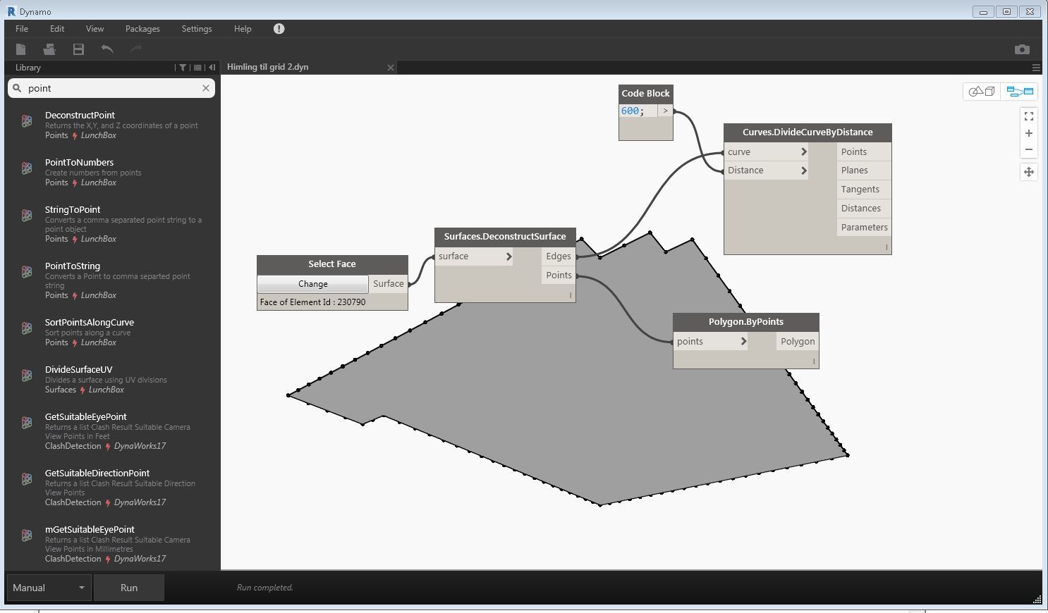

Hi @Kjell_Vidar_Andersen
There are node changes for Curve.Divide By Distance. You can find here: https://github.com/DynamoDS/Dynamo/wiki/Dynamo-Node-Changes
@Mauro Thanks for your reply. I don’t think he is looking for point on surface. He is looking for outer edges(Curves).

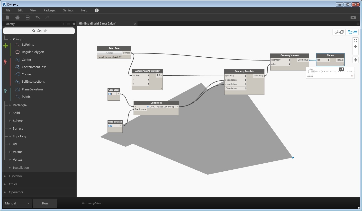

Yeah it was like that. But Im only getting one point?
change the lacing of the node geometry.translate to cross product, then you might want to hide it
That worked great, didn’t know about the possibility to change the lacing. Thanks
@Kjell_Vidar_Andersen You could also determine the parametric equivalent of the distance
pointsAtDistance.dyn (15.1 KB)
