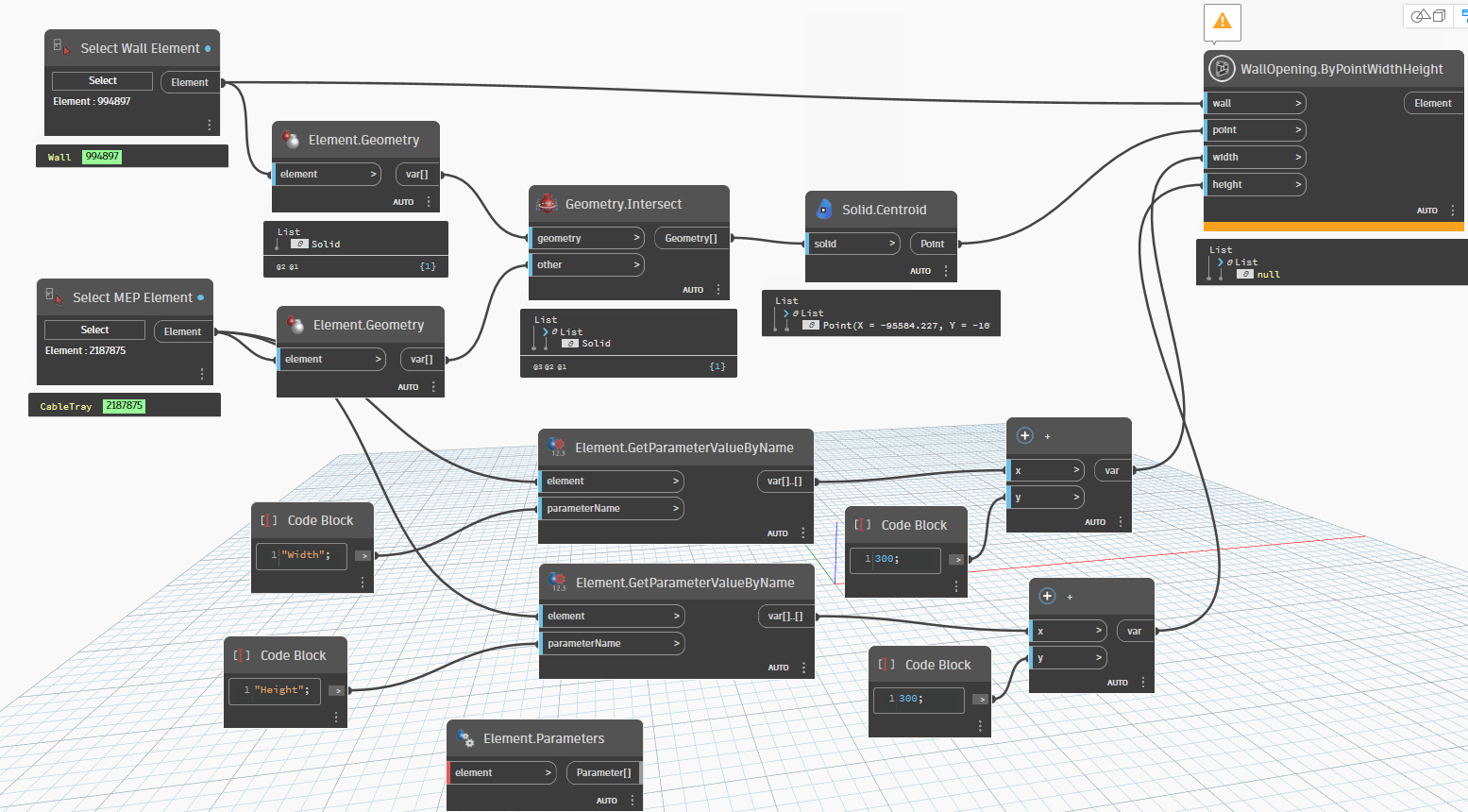

Please help. New to this.. why wont this work. I just need an ope in the wall
Warning is Wallopening.by pointwidthheight operation failed. can not load type ,autodesk.revit.DB.DisplayUnitType’ from assembly ‘revitAPI,Version=23.0.0.0 Culture=neutral, publickeytoken=null’.
What package is that from? Looks like the node was built for a different version of Revit than you have (ie: Revit 2022 or 2021 instead of 2023) so it is trying to load a Revit class (UnitType) which doesn’t exist in 2023 and up (the new type is called ForgeUnit if memory serves).
