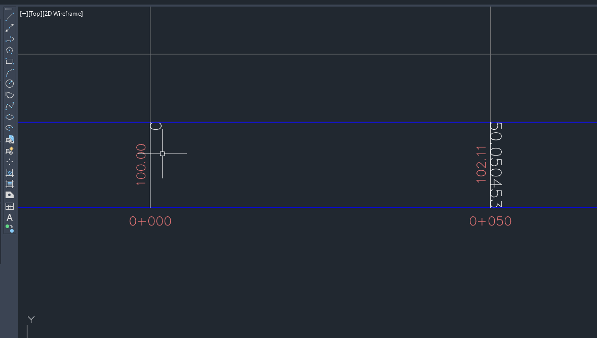

I have place 3D Length with text object in the profile see

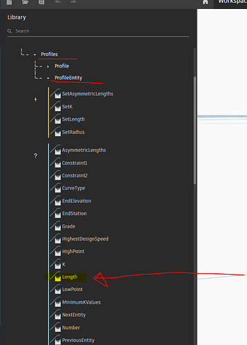

TRY
@hosneyalaa @yaseminV2XL5 A goal is to put text object with cumulative distance as you can see in the attached drawing where text have placed, we can get coordinates, but the think is how we can convert coordinates to cumulative distance see here

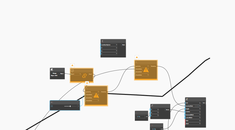

CH Test F.dyn (53.6 KB)
SSDD
@hosneyalaa What are those errors is it from the Add-Ons packages which i need to install,
Yes - check the workspace references when you open the file.
TRY , YOU MUST USE CIVIL 3D 2026 ,SO THERE ARE errors
