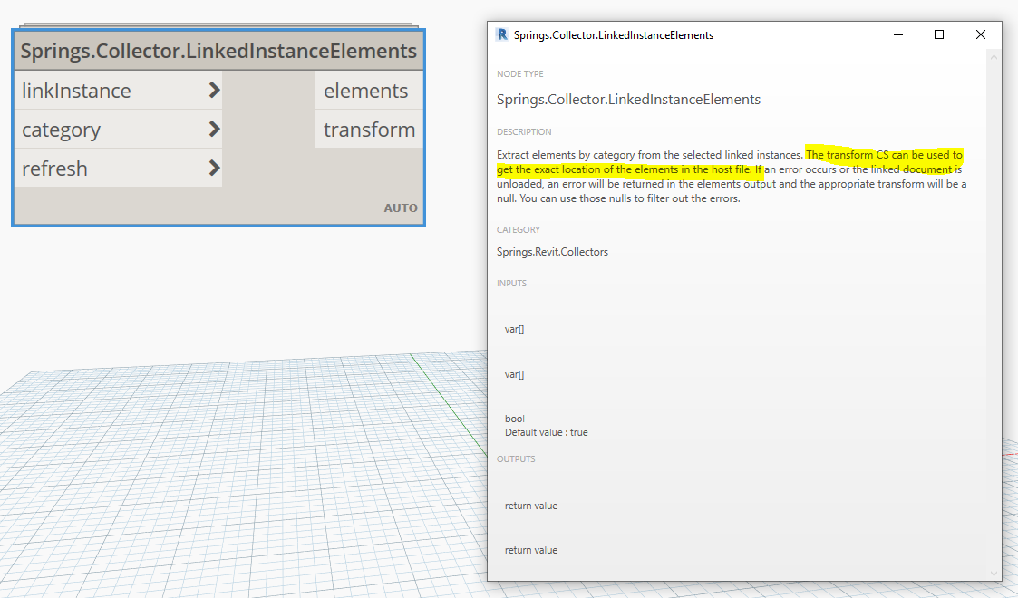

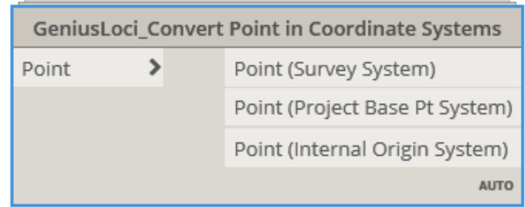

Hi @Kulkul, but how do I place the elements in the current documents with the exact same position/orientation/transform, given that I have that exact family in my current document? That’s the only thing I can’t seem to solve.
