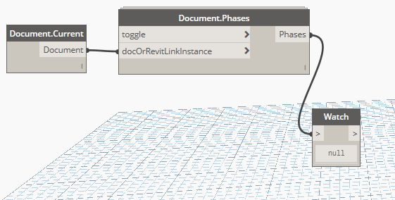

i’m looking for a way to choose a phase using the name. I tried using Clockwor’ks Document.Pahses but i only get null if i use Document.Current
No need to use the Document.Current on the docOrREvitLinkInstance input.
That’s only needed if if you want to query a linked model.

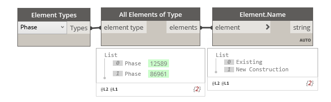

Could do the same OOTB …
