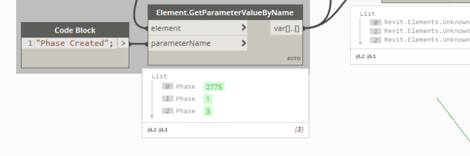

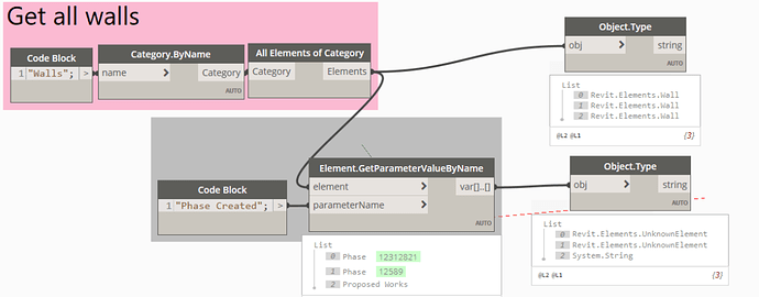

I’ve fed all my walls into this node to find which phase they were created on.
Why do the ones created on the “Proposed Works” phase say the name of the phase but the ones created on the other phases say the phase number instead?
Why don’t indexes 301 - 312 say, “Phase 0”?
Happens on other projects too.

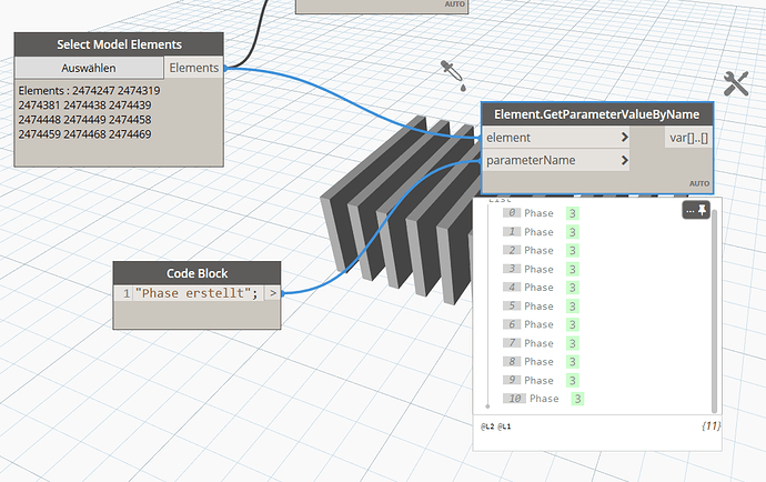

hahaha look what in Austria happens

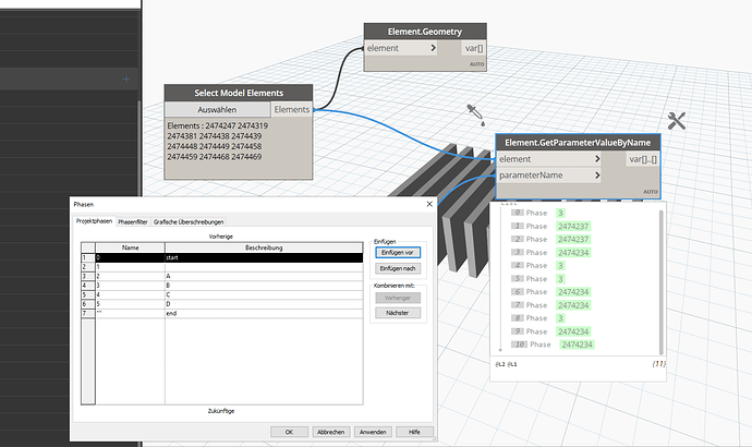

What happens when you have more than 1 phase?
@Alien ,
i randomly asinged phases
So my Dynamo is broken? :expressionless:
@Alien ,
hahahaha… Dynamo breaks always me! :wink:

So I think it’s something weird with our company template as I just started a blank model and recreated the phases and I didn’t get the same result!
If it’s not a bug it’s making me think that something else is controlling the phase for those elements, eg. curtain wall, group, something else, and that’s causing the value to be a string instead of the actual element. Can you use Revit Lookup to snoop the parameter value or recreate with python?

I am going to guess it has something to do with the fact that the phase has an ElementId of 0.
