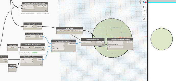

here is a possible way
In the proposal it cuts the circle into 3 parts instead of 2 but still works (strange)

Hola Amiga Camila @camirozario buenas. not a solution just some ideas play with mathematical operations take care that you have variable ranges between 0 and 255 to be able to change the color using Color.byRGB, i let you the .dyn to!!

Hi everyone, first @Robert_Younger thanks for the suggestion. I am used to the GH interface but not Dynamo, at first I was very confused with the nodes I had to use to achieve my result. Thanks @gilberto.arechigaiba and @christian.stan for providing interesting solutions! I ended up working with @gilberto.arechigaiba definition and just tweaked it a bit so I could have a predefined set of R,G,B values assigned to limited values of diameters
It works beuatifully! Also I would like to ask if I use this filled region in REVIT now will it change the fill colour following those parameters or can I only achieve this inside of the Dynamo interface?
Thanks! I am sharing my def ( even tho it is basically what was shared here with a few tweaks)
