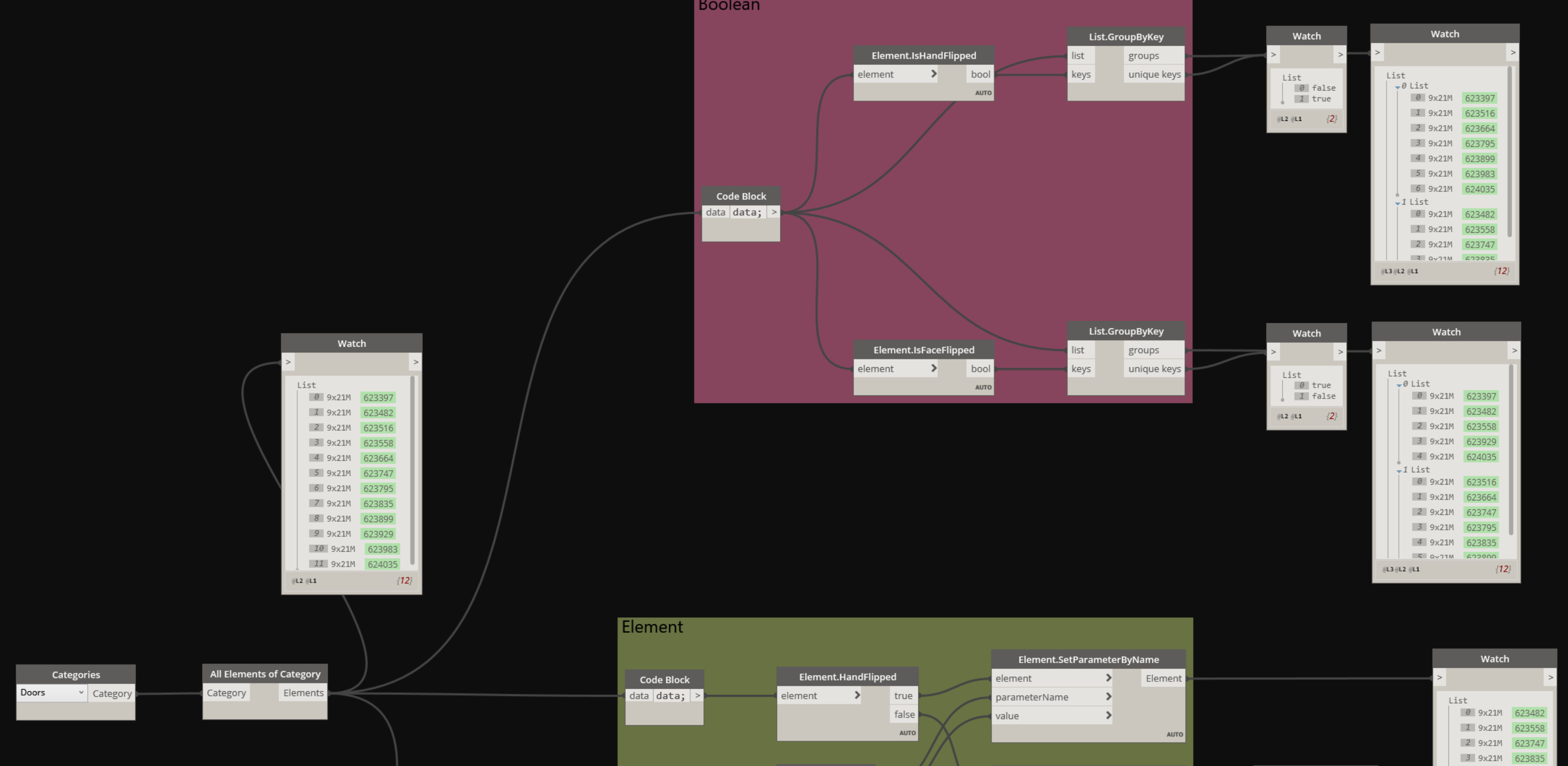

The nodes you mention are accessing the “ToRoom” and “FromRoom” parameters, which I also want to use. That’s all working fine, the issue is that for each door I have to choose which of those two rooms is the one the door is actually swinging into. I was hoping that the flip-arrow you click to flip a door would have a boolean associated with it somewhere that I can access.
from the orchid nodes
