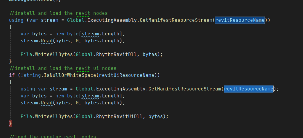

So I found my UI bug. It was on my end. I was writing the RhythmRevit.dll twice with my view extension, once named as RhythmUI, resulting in no UI nodes.
I apologize to Dynamo for blaming it for my mistep. lol
