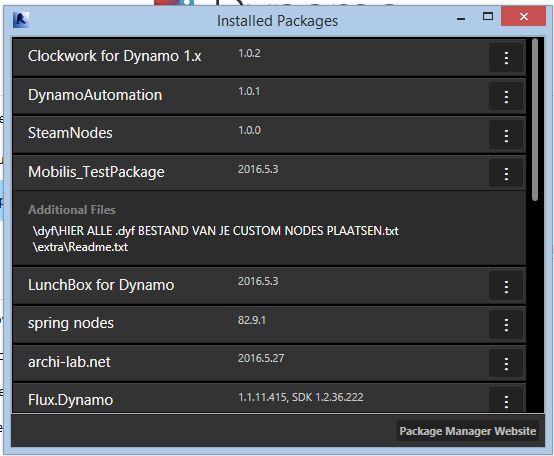

I am trying to make a custom package using dll’s but the dll are not pick up by dynamo. See image below.
Other packages with dll’s have there node libraries listed but mine are not listed.
What am i doing wrong?
I can’t find anything in the log file in the dynamo appdata dir. Is there a log file somewhere else or can i change the log level??

I got it,
The compiler settings where wrong.
I copied the settings from https://github.com/teocomi/HelloDynamo and removed the <preffer32bit> tag from the project file. it is working now.
The only problem i now have left is that the INodeViewCustomization classes do not seem to load. The library is loaded and i can select the node in the node browser but the node is yellow and it does not work and the custom WPF components are not displayed.
If i copy the INodeViewCustomization class to the same project als the NodeModel classes everything works but i preffer to keep them in a different project.
