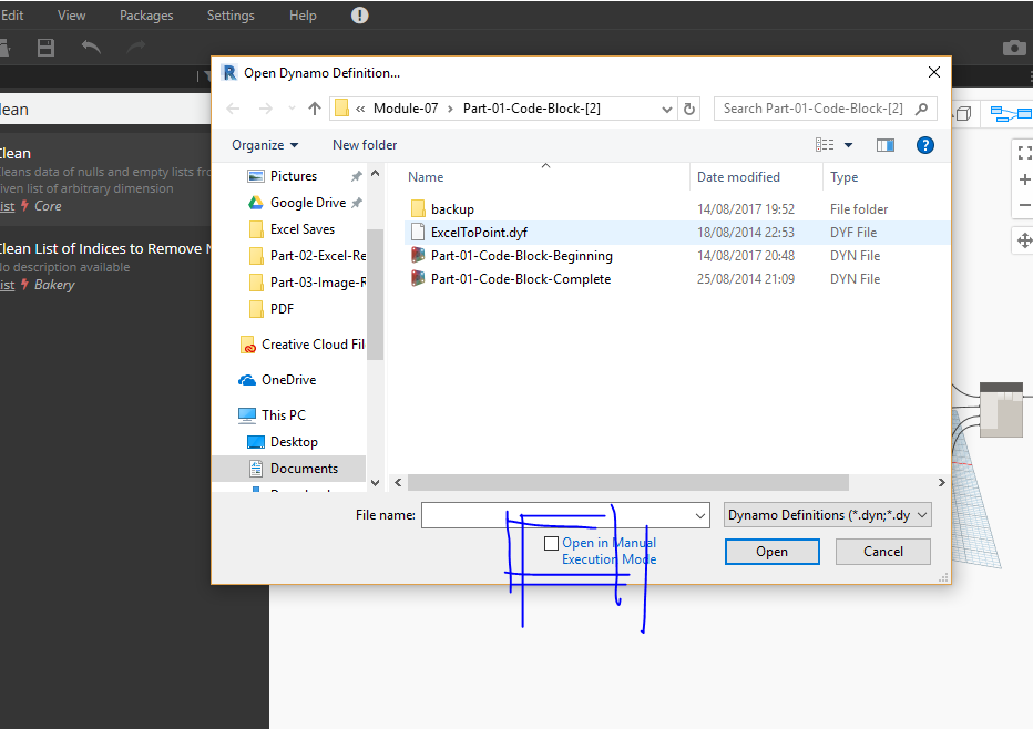

Hey Cesar,
While opening a new file, tick the box as shown in the given PNG file below.
You can either install 0.7 and run them as-is OR you can install 0.9 (someone may have to correct me on this) and save the files in 0.9 before opening them in 1.3.
