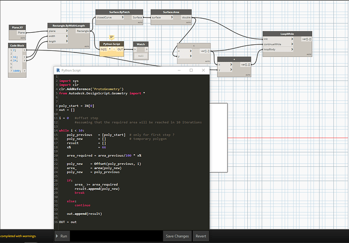

I think this problem could be solved with ‘while loop’. I am new to python so I wrote the problem in english / gibbresh :slight_smile:
I have a polygon and I want it to keep offsetting inside till the area becomes the x% of the initial polygon area ( lets say 66% ) of initial area.
Logically it sounds easier. But I could not trace it. I tried nodes as well, no luck so far. Any help would be appreciated.
Thanks in advance to any hero

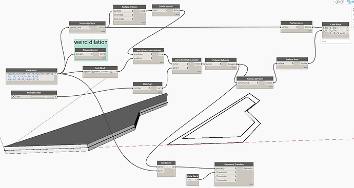

@Alien - Very cool solution! I wrote a similar python node that for another post that uses offset to get to a target surface area (which you get using the percentage calculation in this case). The main difference between the solutions, is that you are using a linear step for the resolution, and I used half steps which makes the curve more logarithmic.
I’m inspired to see how you made your own surface area calc! I would suspect it’s more performant than the alternate surface by patch, then get area.
here is a dilation approach
11 juillet forum anglais.dyn (31.2 KB)
But the offset is not regular
cordially
christian.stan
Very cool!
I think this is similar to what @jacob.small was recommending, where you would effectively scale the shape for the exact calculation.
Seems like the centroid z offset from thickening had insignificant impact on the area calc. If it was pulled to the same z, i would suspect that it still works.
It’s elegant how it’s executed with just a few nodes!
