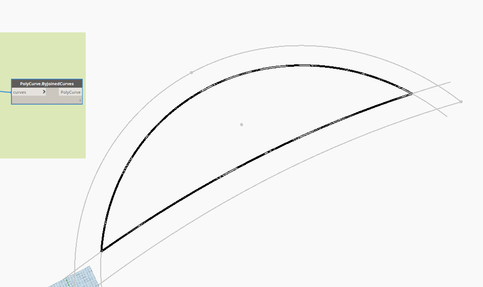

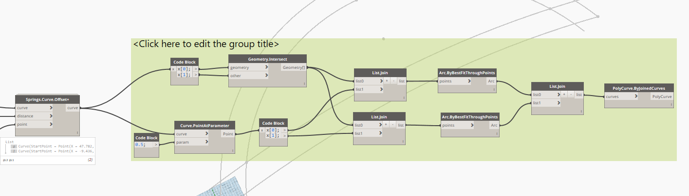

I’m trying to offset closed polycurve made of several arcs. I used different nodes, but apparently i’m only able to offset separate curves. Any workaround for this?
offset polycurve.dyn (9.6 KB)

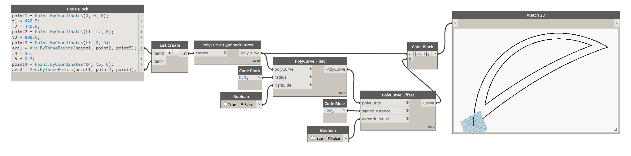

@robertobatista Here is a workaround for a negative offset
This won’t work for a positive offset as the resulting geometry would have rounded corners.
I’ve tried your method before and It works, but I was hoping that there’s a node that works similar to the curve offset node.
