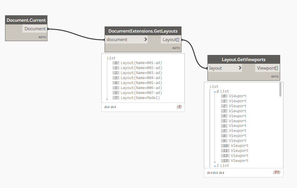

I am trying to retrieve the blockreferences inside a specific layout (or inside the viewports inside that layout) but I am not able to do it.
I have multiple layouts and in each layout there are multiple viewports. The viewports are in the same position in the modelspace but with different layers turned on.

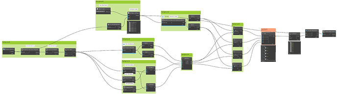

Something like this perhaps:
