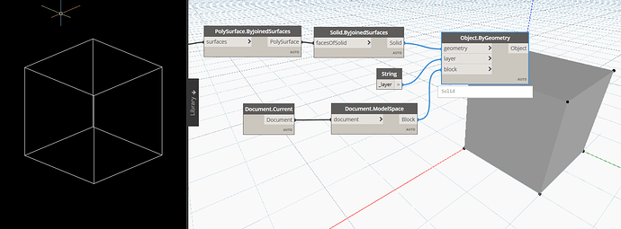

Hello everyone!
I have been exploring Dynamo for Civil 2020 (Update 2) lately and creating AutoCAD objects from Dynamo went smoothly. But since recently node Object.ByGeometry returns only null value despite no other errors in workflow and in .dwg file nothing changes. If I create Solid in some other way (Solid.ByLoft…) the result is the same.
I reinstalled Dynamo via Autodesk Uninstall Tool/ Desktop App but it does not resolve the issue.
I attached a simple cube workflow.
Thank you for suggestions!
[cube.dyn|attachment]cube.dyn (78.6 KB)

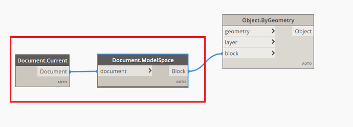

Hi @MatevzB
Block should be ModelSpace:
Hello @Kulkul,
I changed Block to the ModelSpace but it does not resolve the issue.

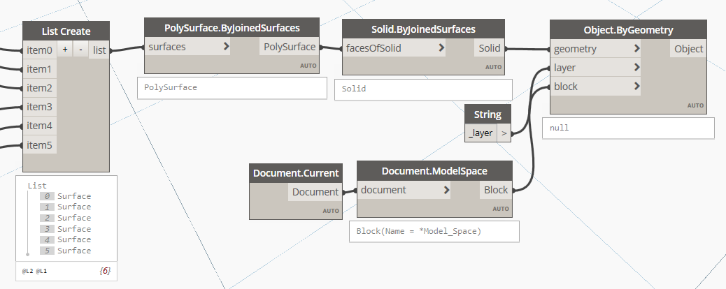

Looks good to me:
Which version of Civil3D are you using?
Until recently it worked for me to.
I am using Civil 3D 2020.3, Dynamo Civil 3D 2.4.1 (all of them should be up to date).
Try running on new C3D template.
I tried running it on a several other templates that come with Civil but none of them worked…
Try a layer which exists, and try using another methof to create your cuboid (cuboid.bylengths, or extrude a rectangle).
Try Uninstalling C3d and install back again.
Uninstalling C3D and installing it again resolved the issue.
