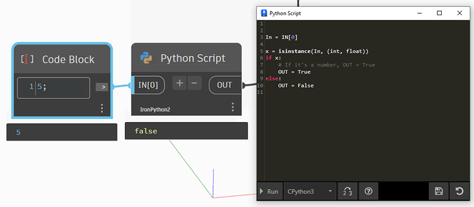

TIL (from GPT) :
In Dynamo, the reason your code is outputing False when you input 5 from a code block, and Dynamo identifies the type as System.Int64, is due to how Python within Dynamo handles data types. In Dynamo, numbers can be represented as System.Int64 or System.Double (among others), which are data types from the .NET framework, rather than Python’s native int and float types.
When you use isinstance() in a Python script within Dynamo, it checks against Python’s native types. Since System.Int64 is not directly recognized as Python’s int, the check fails, leading to False being output.
This seems like a bit of a bug… Will this maybe be ironed out in future releases?

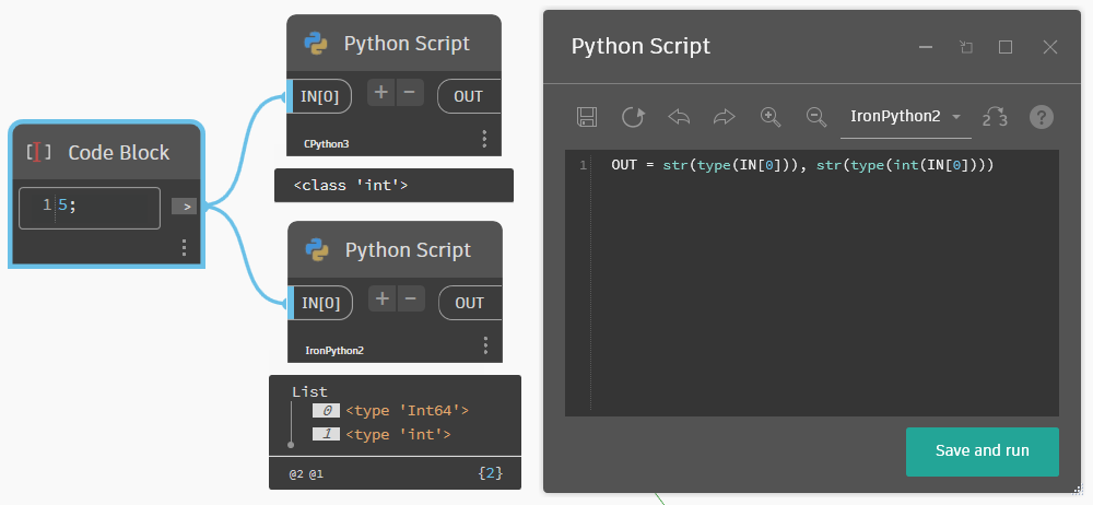

Sort of is, sort isn’t. I agree it is confusing though. 64 big ints are a data type of their own in CS, longs (and floats > doubles). I believe they went this way so we wouldn’t run out of integers for elementIds as well as other reasons I’m probably not versed on
It could be considered a ‘feature’ of IronPython, CPython3 evaluates an integer from a code block as int type
I ended up doing a catch all…
if isinstance(IN[0], (Int64, Double, int, float)):
But seems very OTT.
