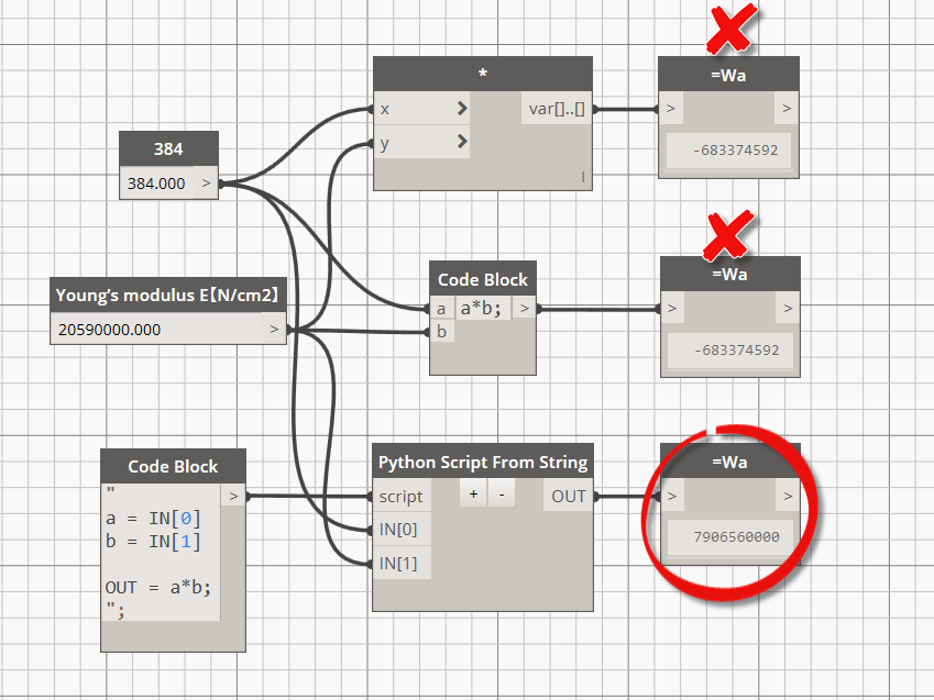

Hello, I have a question.
There are differences in calculation results.
What is the cause?
thank you for your answer.
The unit of the numerical value is too big.
In such a case, it seems necessary to calculate by using Python or changing the unit of numerical value.
It was very helpful. Thank you very much.
Exactly, making either of the inputs a double will also do the trick in this case.
