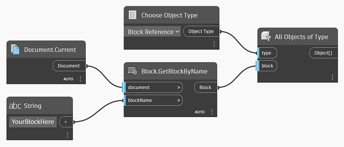

I’m trying to filter out non-BlockRefs in a list but I keep getting a non-pointer error
Hi @Reed_Weinstock,
If your goal is to get all the block references in a block, I would recommend doing it this way. This will be a little more robust.
You have the wrong input - you’re not providing a boolean mask.
Forgot to put in string.contains
is Block.GetBlockByName an OoTB node? I’m not seeing in C3D 2023
You can use the Document.BlockByName node in versions prior to Civil 3D 2025.1.
