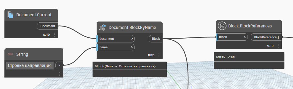

I have to get all block references of the given Block name. But the first issue is that It does not select all block references, and the second issue is that sometimes it does not select any block references at all.
Is the block a Dynamic block?
It is
So each dynamic block reference actually becomes a new block in order to maintain relationships quail ensuring uniqueness… it’s a pain. I believe that Camber or Civil 3D toolkit have nodes for what you’re after - search for DynamicBlock as a start.
Hi @avetik.kagramanian,
If you’re able to update, this was a bug that was fixed in Civil 3D 2025.1. More info in the release notes.
