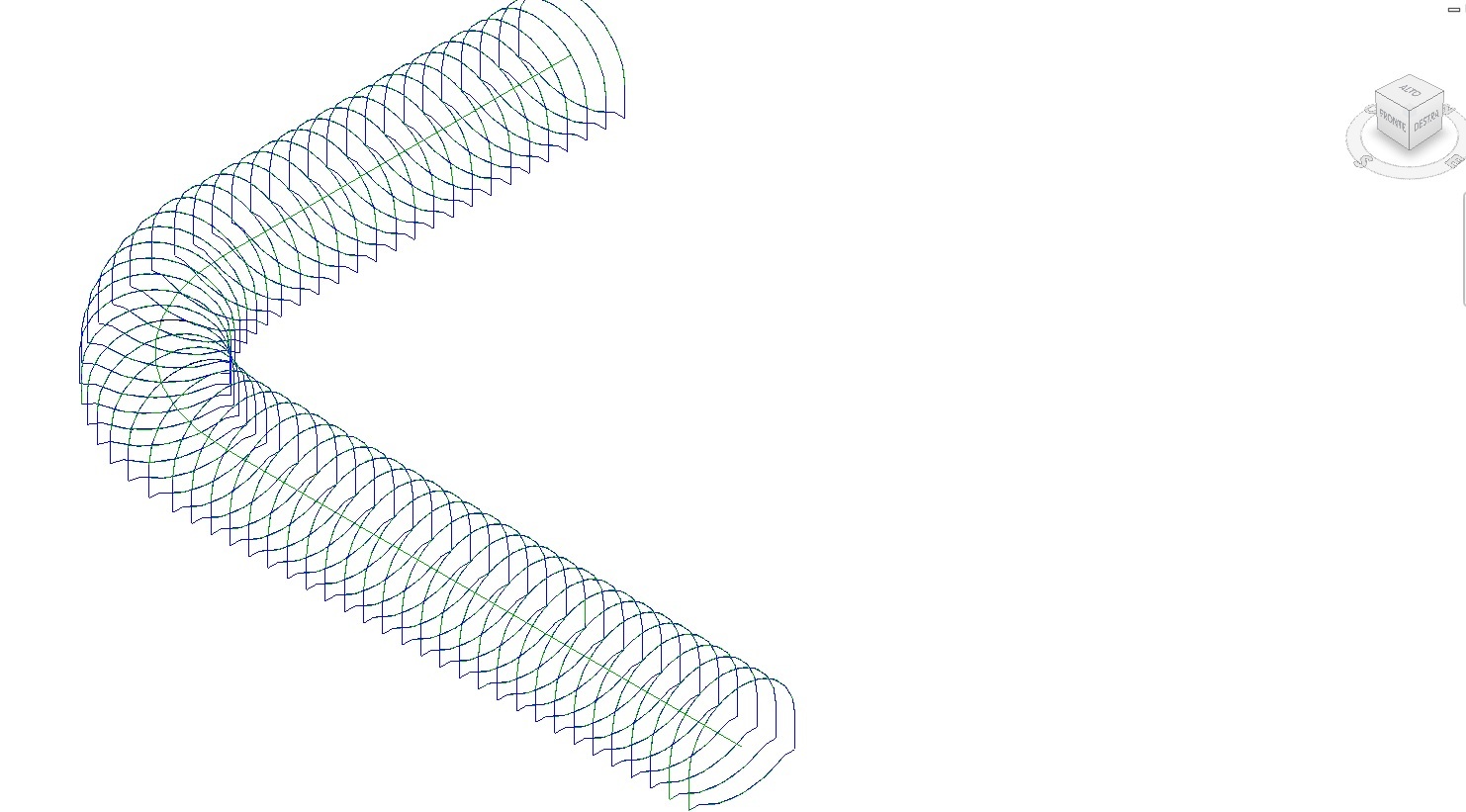

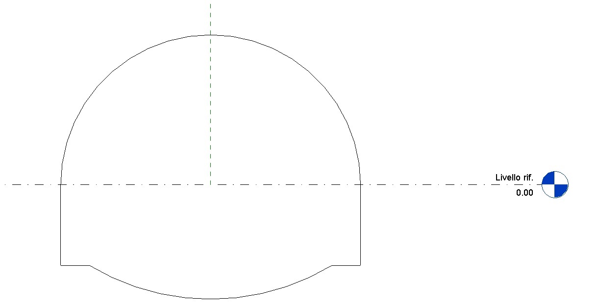

Family consists of arcs and lines (see picture)
Family on track

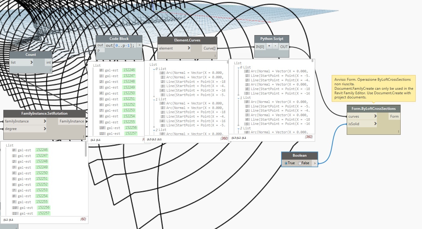

I want a solid between the sections
With Form node. ByLoftCrossSection but does not work
Help?
Thanks for collaboration
Hi @alex_volt
Currently your feeding “String” to “IsSolid” you need to connect “Boolean” node or use code block “true”.

I tried but it still does not work
You’re feeding the node Revit model curves. That can only work inside a family as the message says.
You need to connect Element.Curves directly to Form.ByLofstCrossection.Additionaly you can try making Polycurves from the curves before that.

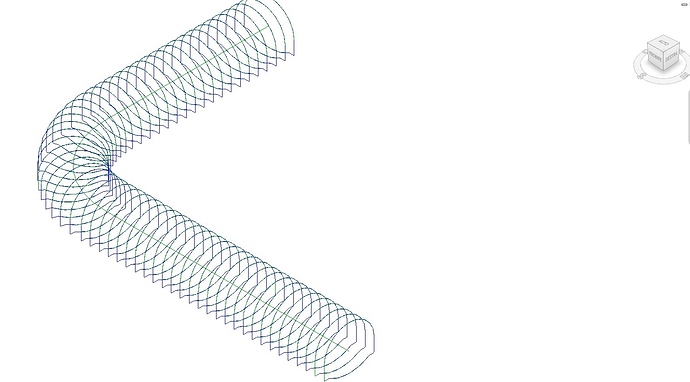

I saw this
but here it works … but I do not think there is a difference
Are you running the definition from a project or from a family?
In the project I entered the family formed by arcs and lines
So the example you showed me is running in a family. Form.ByLoftCrossSection works only in the mass/adaptive family environment.
