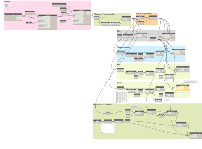

All Elements at Level node, not displaying beams, is it a Revit version issue?
One of you knows why, I found a workaround, this is more questionable
script:
Attribution des noms aux elements.dyn (110.9 KB)
thanks in advance

Use the All Elements at Level+ from the Genius Loci package instead.
It is not a version issue. You can see the All Elements at Level code on Dynamo GitHub if you’re interested by the Revit API and it’s particularities.
I used your custom node, all is well :ok_hand:
