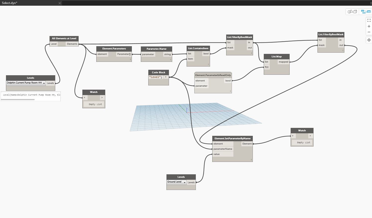

This is intended to help aid in cleaning up unwanted levels in Revit documents. I am SURE Dynamo can do this quickly, but I am extremely new to this programming type and I am a little lost. From a previous thread, I have programmed the following:
I am unsure where to go from here. According to the programming theory, the node “Element.SetParameterByName” should be re-assigning the node level to the level connected to it, but my Watch box shows nothing.
To boot, my first Watch box shows nothing being selected as well.

According to your screenshot your getting “Empty List” at “All elements at Level” node. Could you drop dummy rvt file so that we can have closer look at it.

@Theferrell The problem is specific to your file as you seem to have no elements on the selected level.

Beams are associated with Reference Levels, not Levels
As this is a test, try using some other elements and see if it works.
I tried using some other items like a floor and a column, and noticed that they all have a different parameter name to associate it with a level.
I tried to ammend the Code Box node to say “Reference Level” to try to get Dynamo to look at the Reference Level parameter, but no dice.
Isn’t there a way to make Dynamo show all available parameters and get it to pick items associated that have any items that have to do with levels?
Even if there isn’t there are still only a limited number of element types you’d have to manage.
