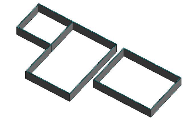

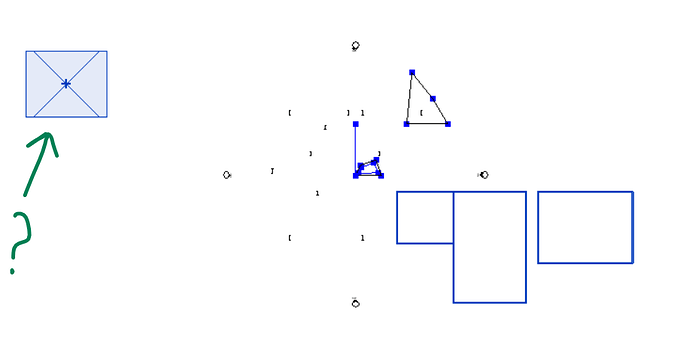

I am trying to create all rooms in a level with a Python Code and it is not working. I am using Revit 2021.1 and the Revit API Docs Method NewRooms2(Level,Phase).
The code should create three rooms, as I have three areas delimeted by walls. However, it only creates one room adn it is not inside any of the perimeters of the walls
Any idea on how to create all rooms delimited by walls at the same time? I attach some images and the code.

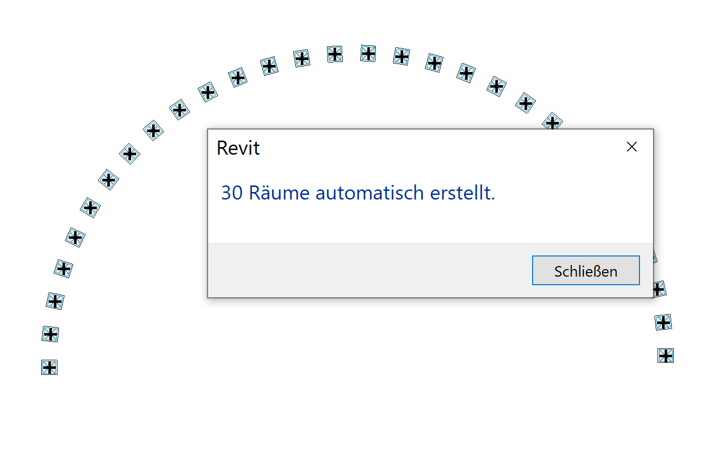

@arantza ,
is autocreation not the fasted way?
KR
Andreas

your code works fine, for the extra room there are non-structural walls in your model
Many thanks!! c.poupin I didn’t notice that I didn’t have correctly selected the discipline
