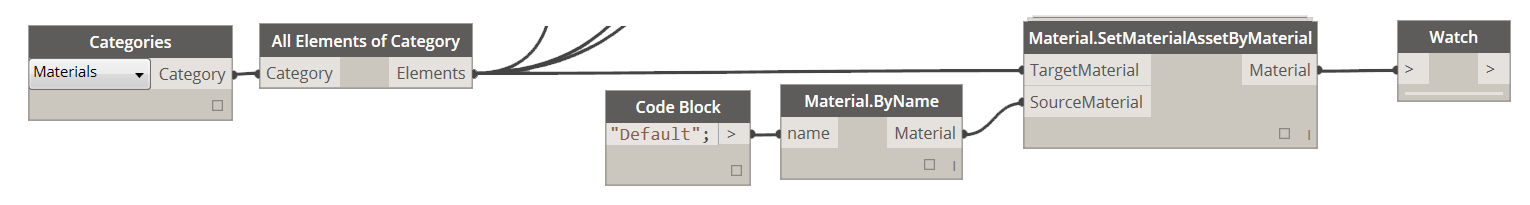

Hi @Batman86
Check out clockwork package custom nodes. Below is an example which i replaced in to new material.

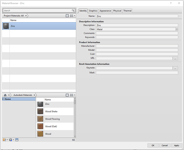

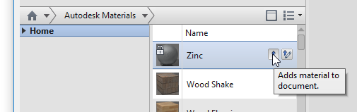

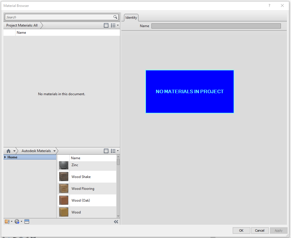

and its great what has been provided however using dynamo to extract materials from the library is what i want. see images below of the process i want to utilize Dynamo
Project with not materials(these materials are not in any project they are from a New Material Library on the server)
Step 1
Step 2
Step 3
Can this be dynamoed?
The Revit API does not allow access to external material libraries. You would have to resort to a clever combination between transferring project standards, copy paste elements with materials assigned, and/or renaming materials.
