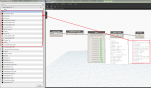

Hi Daniel,
Yes it is possible to get materials from the material library. See below screenshot and also you can set material using “Element.setMaterialParameterByCategory” node from Clockwork Package.
