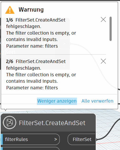

I’m trying to create a view filter using the Archi-Lab blocks, but I keep encountering errors. Does anyone of you have an idea why it’s not working for me? I’m using Revit 23.0.11.19, Dynamo 2.13.1.3887, and Archi-Lab 2023.213.1523.
The warning tells you the filter collection is empty. You haven’t provided anything for the filterSets input. What’s the default value?
The default value is archilab.Revit.Selection.Select.GetNull()

The node Select Rule Type you used is the ootb node, for archilab node you should use the node from archilab. The only difference is the upper/lower case from the string output.
