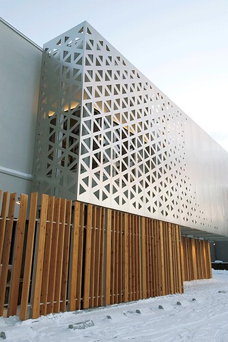

I’m working on modeling the Ichii Renovation façade in Hakodate, Japan, using Dynamo. If anyone has experience with creating complex facades or can provide guidance on how to approach this, I would greatly appreciate your help!

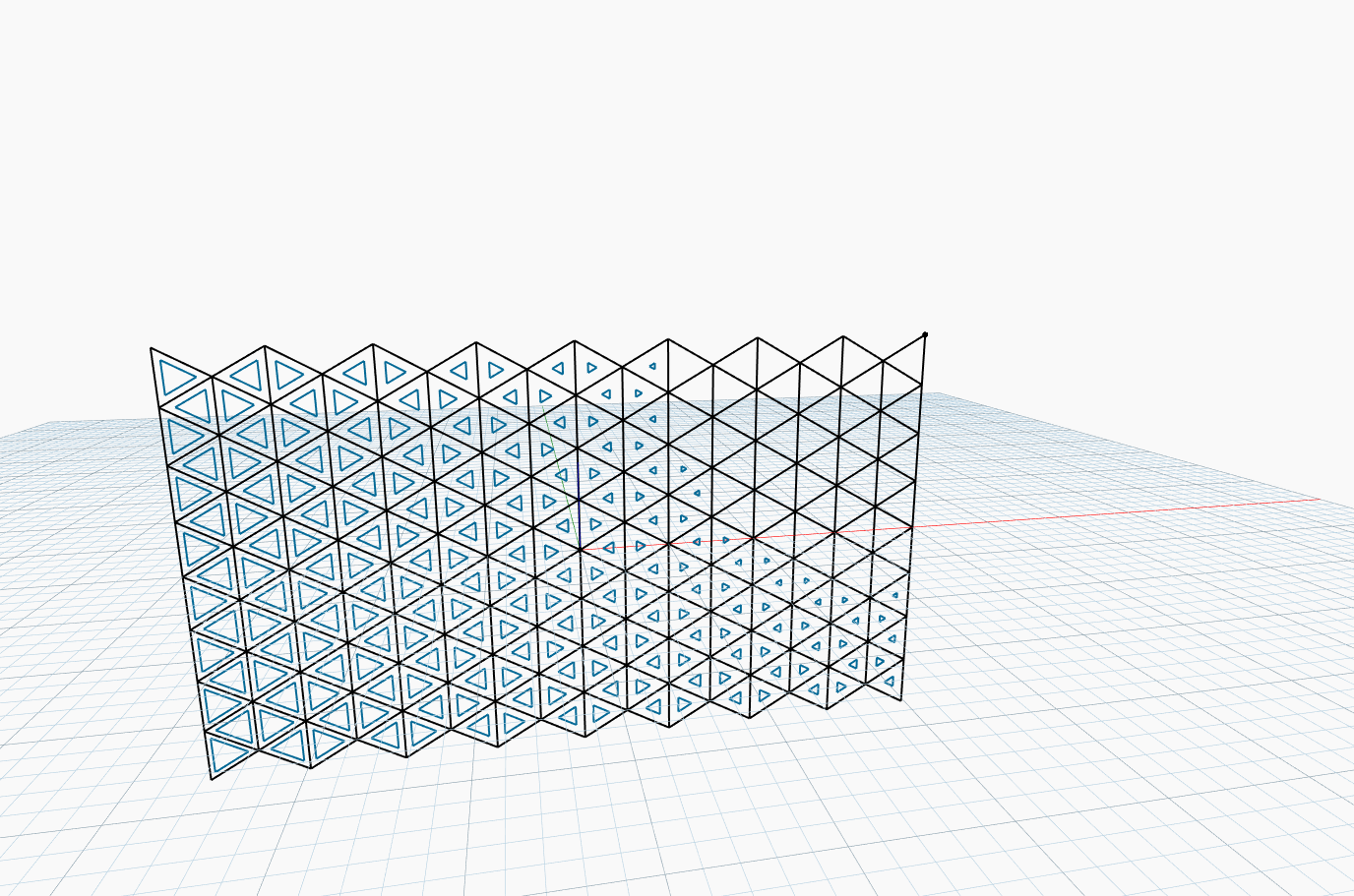

sure! i am trying to add the triangles but…
What does the building look like though?
Nevermind see the edit in the previous post.
Look into the pattern toolkit package, or if you are in a newer build you can use the paneling nodes.
More info on the paneling nodes here, about half way down: Dynamo Core 3.1 Release - Dynamo BIM
Here is an example PanelSurface to get you started. There will need to be a scaling function based on some criteria - here I’m using distance to a sphere placed at a max point and filtering where points are inside
