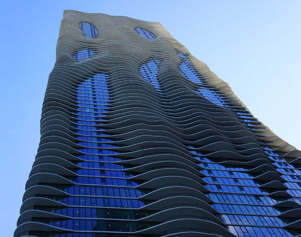

Hi there! Is there a work package that creates horizontal facades on dynamo? I want to create something like this for my building but I’m not sure where to start…
Hi, your question is typically not a great way to recieve an answer in here, but I’ll give you some pointers/inspirational posts. Come back when you’ve tried and we can help you further. Or you can probably give @solamour a call!
If I were to have a go at this, I would first generate a mass representing the overall geometry, then create planes at each level, get the intersection between the mass an planes, and use the derived curves to create a floor in Revit. (or maybe just mass flooring in Revit native)
