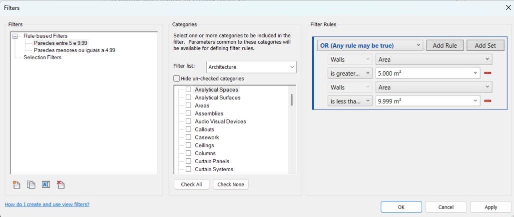

  • I used FilterRule.ByRuleType to create two rules (one ≥ 5 and another ≤ 9.99).
  • I passed these rules into ParameterFilterElement.ByRules.
The filter gets created, but inside Revit it always shows as OR (Any rule may be true) (see first screenshot).
What I really need is AND (All rules must be true), just like when I create the filter manually inside Revit (see second screenshot).

Hi Luiz, welcome :wave:
The node that creates the filter is hard coded to use LogicalOrFilter [see GitHub here if interested] so you will have to either manually adjust after (Boo!) or try using archilab nodes which has FilterSet.CreateAndSet. Note you will have to use all archilab nodes in the workflow

Gotcha - the AND filter will be inaccessible at creation without custom scripting then, as it is hard coded in the out of the box nodes. You could look to set it after the fact as noted by @Mike.Buttery, but I am not sure how easy that is without either scripting or custom packages.
