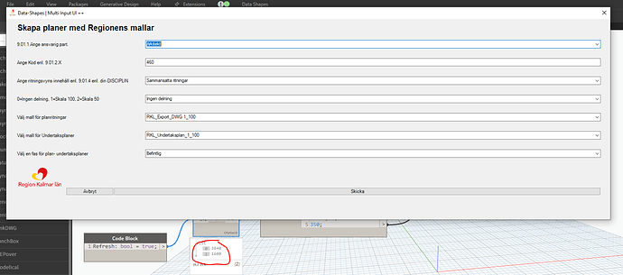

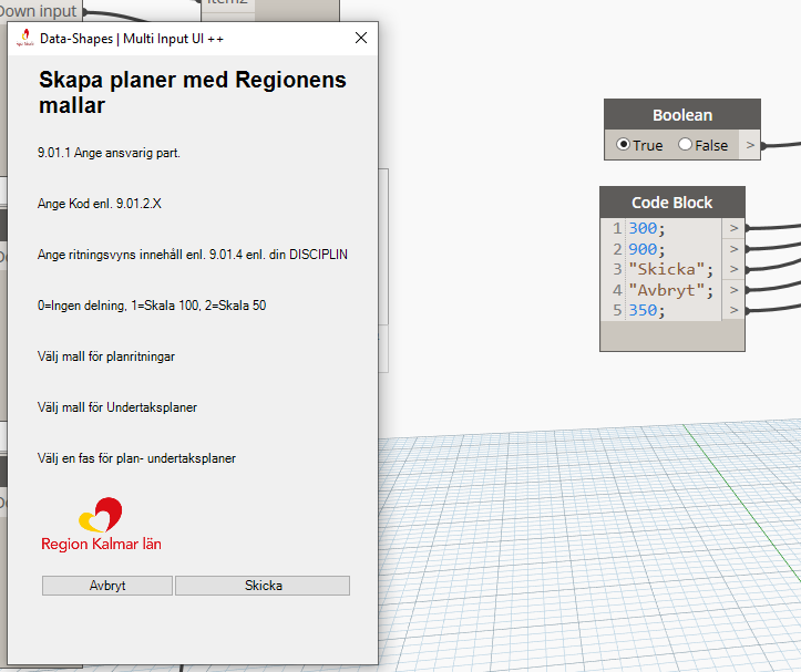

Is there anyone that has a solution, the MultiInput UI displays different depending on sreen.
With the same settings it presents it self different.
Any soulution?
This image is from Laptop
This image is from a 17" screen
While this image is from 27" screen

The only thing is that the image is ontop of cancel button.
Laptop
17"
27"

Seems that picture scaling is not linked with different display resolutions correctly in Data-Shapes. We can see, that on 27 sample picture is much bigger than text above it, but in 17 and Laptop it’s about half of size of text above it.
