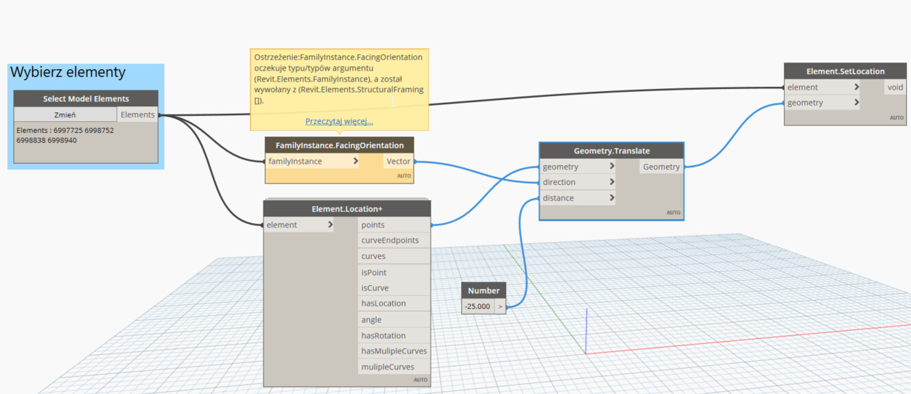

I’m working on a script that would move the beams by the vector.
Assumptions:
I want them to move by the given vector relative to the starting point.
Here`s what i created:
I also tried this, however it doesn’t work
However, maybe it is possible for the beams to shift in relation to the local coordinate system? I am asking because now you have to switch nodes so that individual beams move in relation to the starting point.
