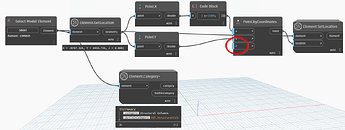

Depening on what kind of elements you want to move, you can use Element.GetLocation (old Coordinates) & Element.SetLocation (New Coordinates)
could you help me a bit on that? i set both but not having any result at all
Okay. Please read the Description of the Nodes. This will give you a clue on to put in the inputs.
Example: You have some Generic Models which are point based.
If you select the Elements with Dynamo and you put them into Element.GetLocation, this will give you the points of the locations where the generic models are.
You can Move these points using (Translate or Transform) or make new points based in an excel. At this point, nothing happends in Revit.
If you use Element.SetLocation you have to put the Generic models in element and the new location points into geometry. This will relocate the Generic models to these new points.
This also works for other families.
Another Example are Structural Framings. These are Line based. When putting them in Element.GetLocation you will get a curve of some sort. This means you also have to put a Curve into geometry if you want to use Element.SetLocation
(This is actually something I am working on right now see screenshot)
If you need any more help let me know. Maybe share your files so we can help you even more.

@Joelmick i tryed what you shown me and not having results…
When I use the “Element.SetLocation” node, the points from the families move but not the families .
Are you trying to change the offset or something of that kind?
Because i see you are trying to change the Z.
If so, i think you need another approach.
So you cant change this…
…by changing this (AFAIK).
I want to change the elevation of an element. Currently, I don’t have access to the file which means I don’t exactly know how the element is modelled. So, I just placed couple families and test the script. It looks like the “Z” suppose to change “Elevation from level”. I think because the box is grey out so the elevation doesn’t change. I tried another family which I can input the “Elevation from level” and it works.
Maybe the difference is one Family is
Workplane based?
I think you are right. The difference is whether the family can be moved from the host.
