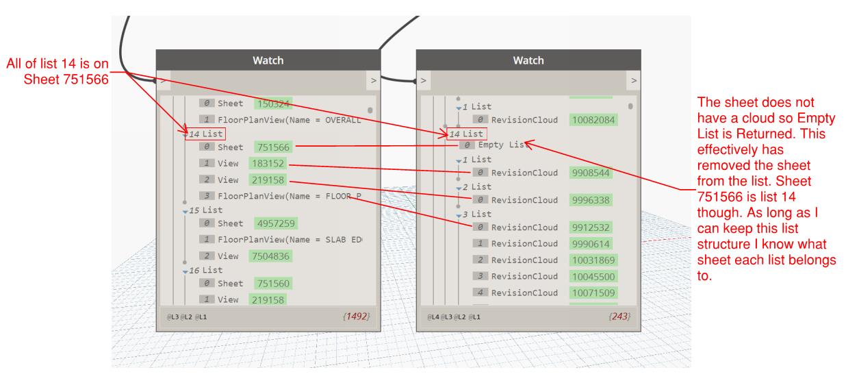

Does anyone know how to find an item at a level and move it down one level? If you look at the image list item 288 does not have the same tree structure as list 290 on the outbound side of Springs.Collector.ElementsINView. How would I go about selecting elements that live @2 and move them to @1. I do not want to move list @2 just elements.

I need to keep the the structure of the list. The current structure is that the sheet is @3 and then each view on the sheet is in the @2 list. This allows for manipulation at the view level but then still know what sheet it is on. This become a problem with legends since you cannot find what sheet the legend is on and why I need to keep the structure.

The List does not necessarily have the sheet in it. The structure of the list Represents the the Sheet. All the clouds in each list @3 are on the same sheet and all could in the list @2 are in the same view. Some sheets (view) do not have clouds on them and are removed from the list of views.

I want to keep this structure so I can remove clouds with duplicate Comments on a per view bases.
I am just missing something (sorry but it’s late here and I will end my day very soon): when do you loose this structure? Could you show a complete graph so that I (or someone else) can see where it does not work?
