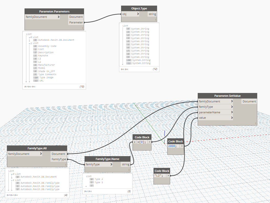

Im working in a Family project, and I need to set value in parameter called “parameter_1” (this is a family parameter)
I cant read that parameters, because I dont know where they exists.
Someone could help me?

@franciscopossetto Check the post below. Does it help?
https://forum.dynamobim.com/t/orchid-package-help/21430/4?u=salvatoredragotta
@franciscopossetto all nodes from the Orchid Package
Thanks a lot Salva! it works perfectly
